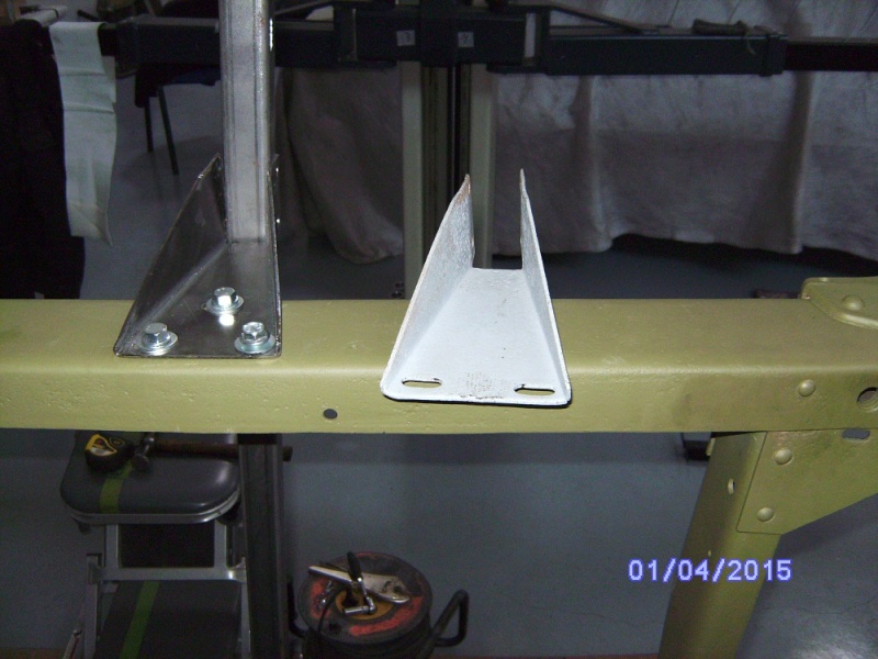

salut Michel comment l'axe de ton frein est fixé sur la profile du marchepied?
Messages : 1645
Restauration citroen trefle moteur - julio ubierna - Page 3 Empty Re: Restauration citroen trefle moteur - julio ubierna
Message  m gosset Jeu 22 Jan - 11:29
Hello Fer,
La reponse a ta question est que l' axe du systeme de frein ( approx 30 cm ) est
fixe a la traverse grace a deux gros etriers :
https://www.dropbox.com/sh/l0xhnh5fy3b5jas/AAAdK86h6fS7mA2fJIKotXOAa?dl=0

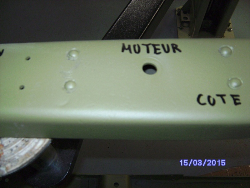

I need to know which holes of chasis are original(cote gauche).
I soulded the holes that i think are not original, i will do new holes

I did a reproduction of the barre for the box of battery like the mesures of the site Willy Schafroth,some body can tell me that it is ok,i need the mesures of the holes in the barre for support of battery,thanks
Restauration citroen trefle moteur - julio ubierna - Page 3 Sany1441
I did a little modification with 3 holes,i think that it is better

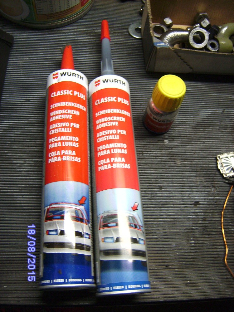

Message  ludo Dim 10 Mai - 14:18
Hello Julio ,
very beautiful work
Can you give the references of the used products?
Friendly

Message  m gosset Lun 11 Mai - 10:36
Hello Julio
In answer to your question "
I did a reproduction of the barre for the box of battery like the mesures of the site Willy Schafroth,some body can tell me that it is ok,i need the mesures of the holes in the barre for support of battery,thanks"
... here are two pictures showing the distance from the bracket fixing the " barre" to the chassis to the two bolts attaching the box to the barre .( Ihave put dots of white paint on the bolts )
This distance is 9.5cm and 23cm:

Hello Ludo , you are doing a very good restauration in your car,i would like to see it someday.
i will take photos the next weekend of the products and i will put it in the phorum

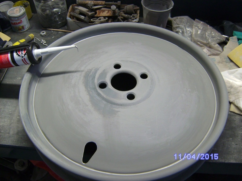

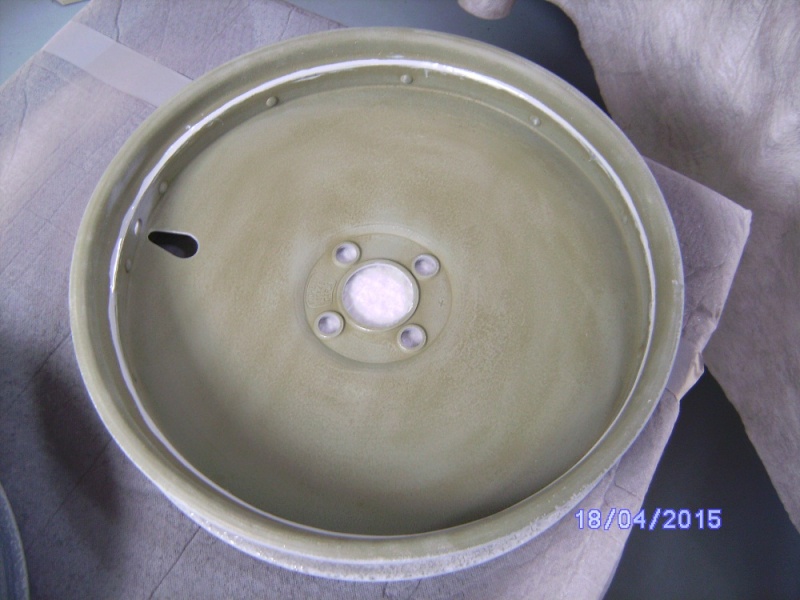

bonjour, a fait hier des photos de l'ensemble du processus de pneus peints, je espère que vous aimez
Good morning,yesterday i did some photos for ludo and the process of painted of the tires.i hope like it
Restauration citroen trefle moteur - julio ubierna - Page 3 Sany1525
Restauration citroen trefle moteur - julio ubierna - Page 3 Sany1526
Restauration citroen trefle moteur - julio ubierna - Page 3 Sany1527
vous devez être prudent avec la proportion de peinture  5/1
you must be careful with the proportion  of paint 5/1
Restauration citroen trefle moteur - julio ubierna - Page 3 Sany1528
Restauration citroen trefle moteur - julio ubierna - Page 3 Sany1529
Restauration citroen trefle moteur - julio ubierna - Page 3 Sany1530
Finally, you will need to apply a quality seam sealer and apply car paint
Enfin, vous aurez besoin d'appliquer un scellant de couture de qualité et appliquer de la peinture de voiture

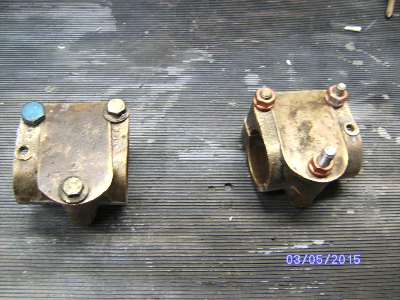

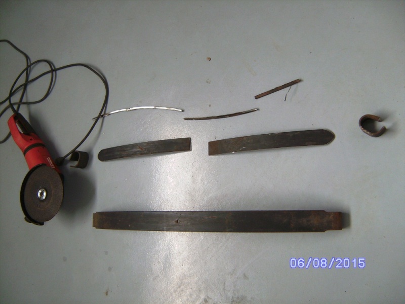

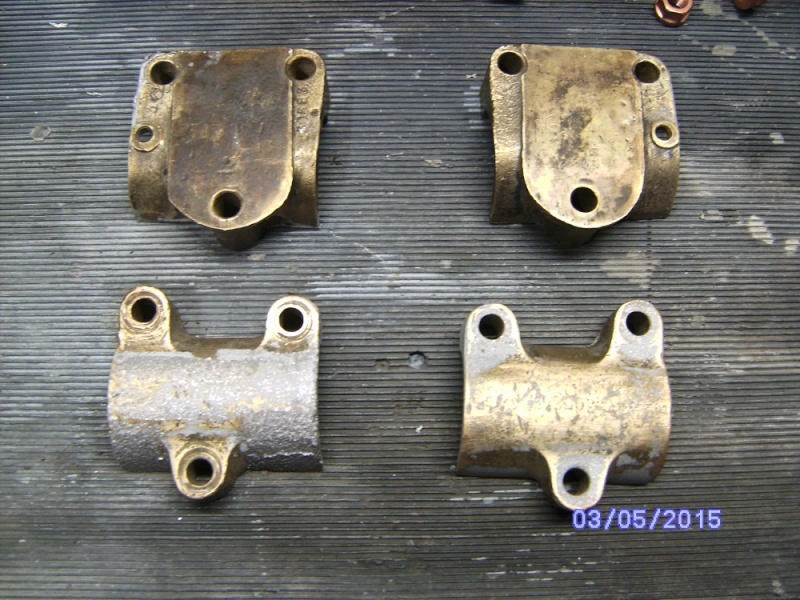

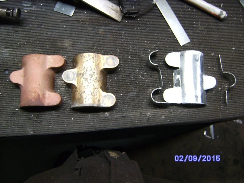

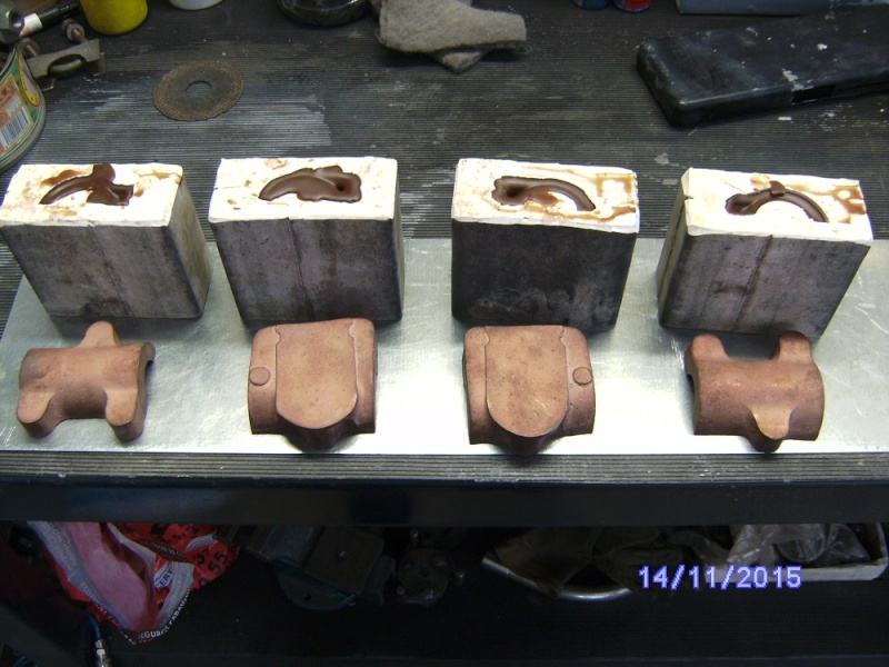

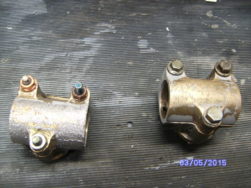

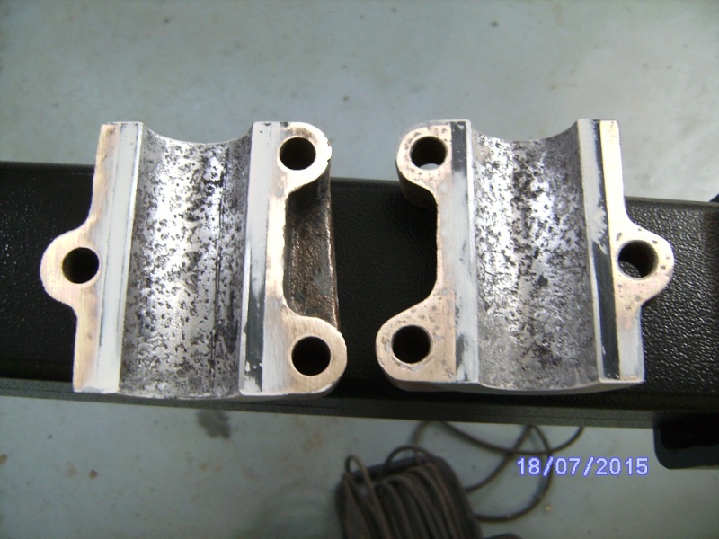

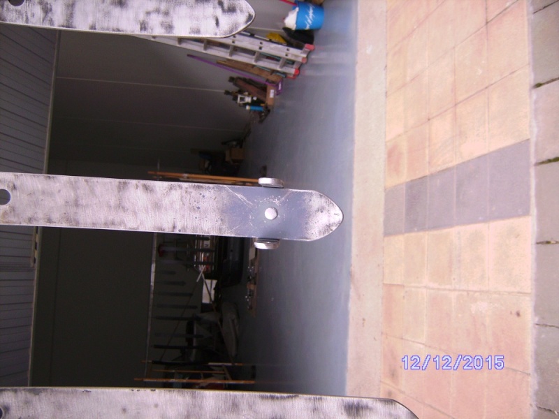

I made a bronze reproduction patins  suspension for my citroen .what I receive in three weeks, it cost me 360 euros, a bit expensive but .....
Restauration citroen trefle moteur - julio ubierna - Page 3 Sany1612
Restauration citroen trefle moteur - julio ubierna - Page 3 Sany1616

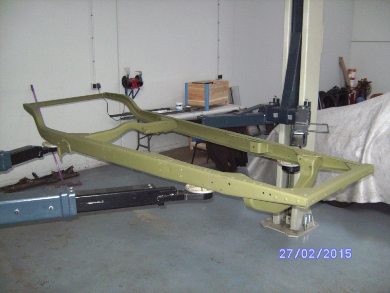

Also, I finally worked with the chassis, we apply another primer, then the product photo and finally glossy paint quality, this is the result
Restauration citroen trefle moteur - julio ubierna - Page 3 Sany1613
Restauration citroen trefle moteur - julio ubierna - Page 3 Sany1614
Restauration citroen trefle moteur - julio ubierna - Page 3 Sany1615

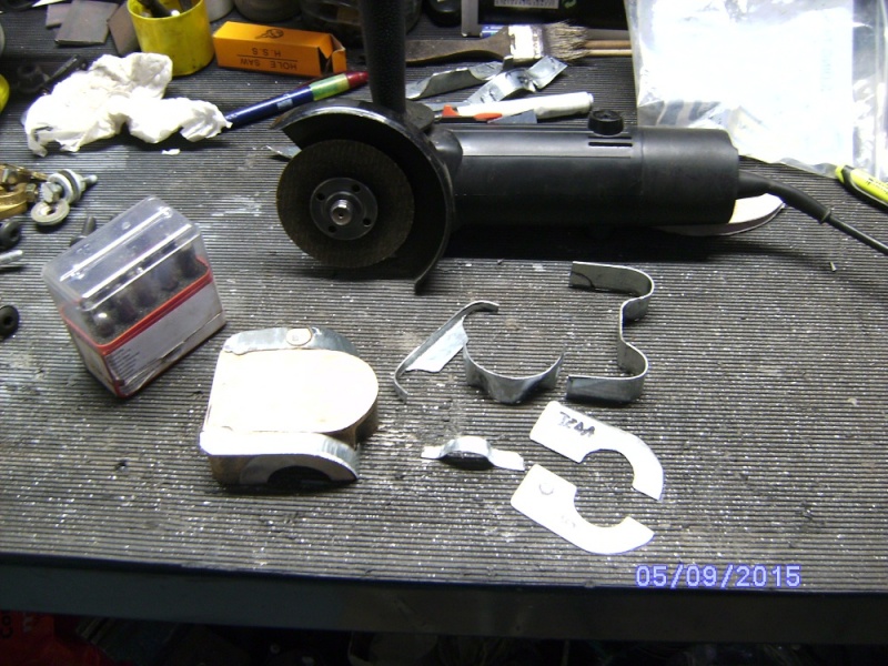

I made a reproduction of damaged parts had, I changed the screws to secure the lames of suspension and I screed welded parts,
Michel, you can correct it, you know that the French language and English is not my thing, thanks for your photos

Message  Fer Mar 18 Aoû - 19:48

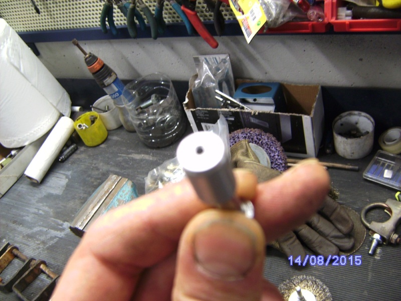

jolie travail. Queseque tu mets dans les bronzes du pont AR?
Messages : 1645
Message  m gosset Mar 18 Aoû - 22:16
Hello Sergio
Fer is asking which material did you insert into your bronze " patins d' articulation"
best regards
Message  julio ubierna Mer 19 Aoû - 22:15
hello Michel and Fer,thanks for your question,i was need some product for do a gabarit for the patins,my patins are in bad condition ,i think that it is a very important part for ours citroen.
I use this product in my job,it is very resistant ,but i have not tested it in this parts,but i think that is not a problem,i did it only for gabarit,not for use .
You must clean the parts,after you must aply the primer, in 10-15 minutes the product. You must wait a few days to completely dry, apparently in a few hours will be dry ,but is not true,
Regards from burgos
Restauration citroen trefle moteur - julio ubierna - Page 3 Sany1632

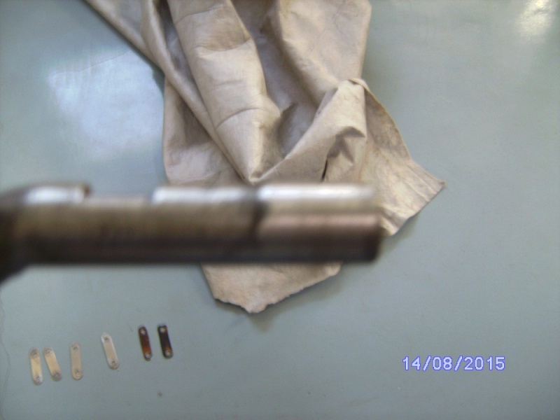

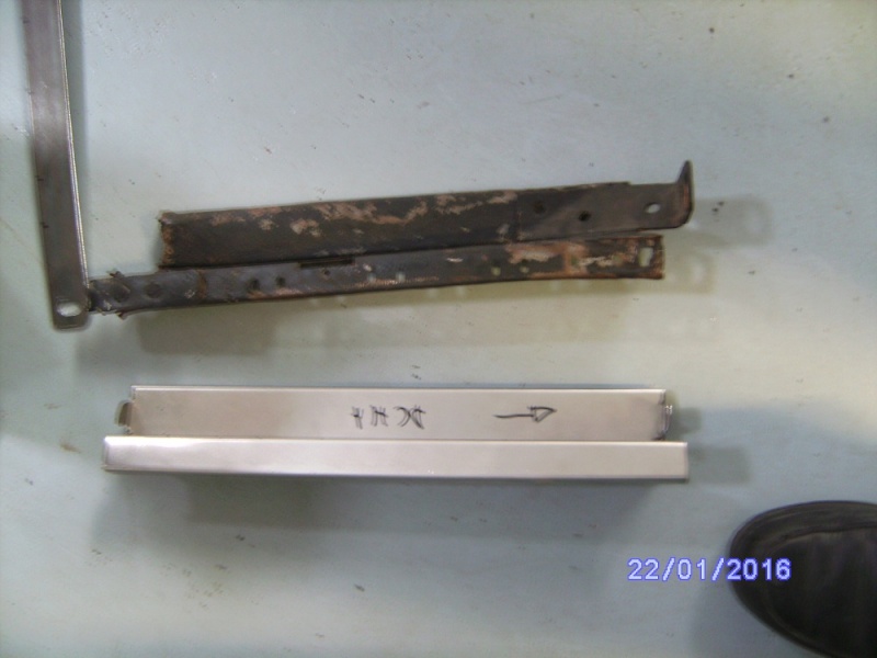

All will remember that i will did a refabrication of patins of suspension, after much time and money with molds, the refabrication not served as they remain quite small to cool the bronze.(1,5mm both sides)
A big problem   Sad  Sad  Sad  Sad  Sad  Sad  Sad  Sad
Tous se souviendront que cela va faire un Patins de fabrication de suspension, après beaucoup de temps et d'argent avec des moules, réusinage pas servi car ils restent assez petites pour refroidir le bronze.
Un gros problème
Restauration citroen trefle moteur - julio ubierna - Page 3 Sany1618
Restauration citroen trefle moteur - julio ubierna - Page 3 Sany1619
Restauration citroen trefle moteur - julio ubierna - Page 3 Sany1715
Je suis assez têtu, donc j'eu l'idée de couvrir la pièce originale de la feuille de 1.5mm, beaucoup de travail avec le soudage, mais ....
I'm quite stubborn, so I had the idea of covering the original piece of sheet 1.5mm, a lot of work with welding but ..
Restauration citroen trefle moteur - julio ubierna - Page 3 Sany1627
Restauration citroen trefle moteur - julio ubierna - Page 3 Sany1628
Restauration citroen trefle moteur - julio ubierna - Page 3 Sany1621
Restauration citroen trefle moteur - julio ubierna - Page 3 Sany1622
Restauration citroen trefle moteur - julio ubierna - Page 3 Sany1623
Restauration citroen trefle moteur - julio ubierna - Page 3 Sany1625
Restauration citroen trefle moteur - julio ubierna - Page 3 Sany1629

Restauration citroen trefle moteur - julio ubierna - Page 3 Sany1716
Restauration citroen trefle moteur - julio ubierna - Page 3 Sany1728
The new refabrication, quite larger for machining to suit your rear axle cheers  cheers  cheers  cheers  cheers
Le nouveau refabrication, assez grande pour l'usinage en fonction de votre pont arrière
Restauration citroen trefle moteur - julio ubierna - Page 3 Sany1718
Restauration citroen trefle moteur - julio ubierna - Page 3 Sany1719

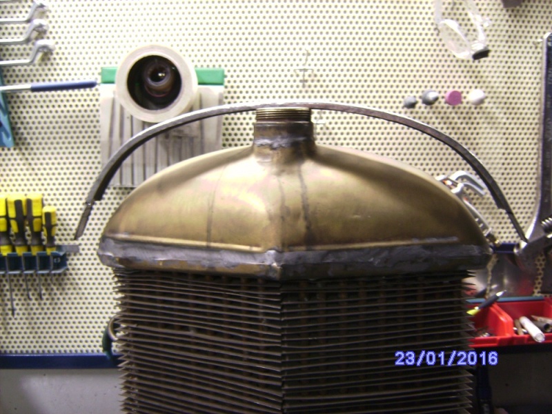

Je travaille actuellement avec le radiateur, lorsque vous achetez la voiture, le radiateur a été réparé, mais eu pièces en très mauvais état, afin de faire les nouvelles pièces pour durer encore 90 ans
